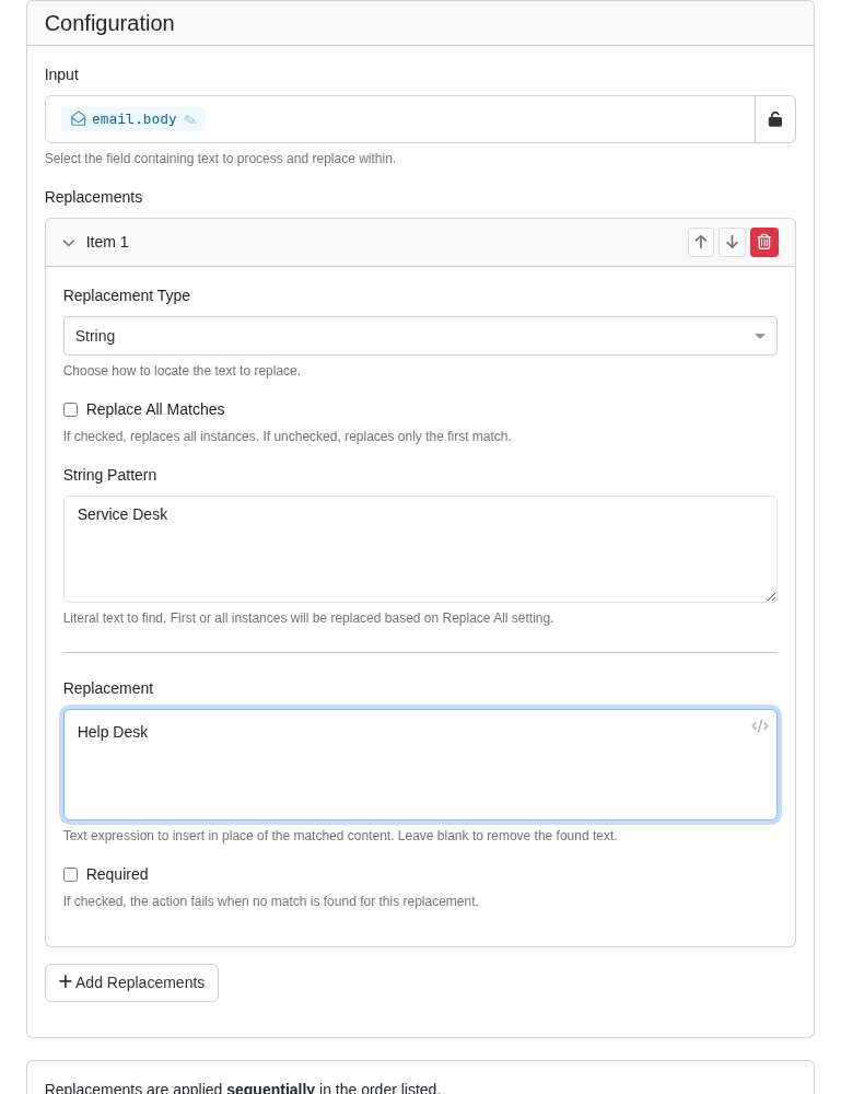

String
Use String for exact, case-sensitive text replacement.
| Field | Description |
| String Pattern | The exact text to find. This field does not support text expressions. |
For example, find Acme Support Services and replace it with Acme Help Desk. Enable Replace All Matches to rename every occurrence.

Example: Remove a Signature and Rename a Team
Suppose an email body includes a standard signature and refers to Service Desk, but the ticket note should use Help Desk.
- Set Input to the email body.
- Add a Start/End Match replacement that removes the signature block.
- Add a String replacement that changes
Service DesktoHelp Desk. - Enable Replace All Matches for the team-name replacement if the phrase can appear more than once.
- Store the result as
CleanBodyand use{{custom.CleanBody}}in the ticket note action.
